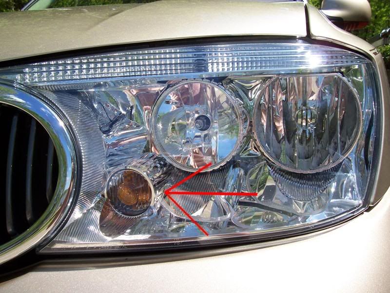

just wondering if anyone could conferm the bulb size with me for the front turn signal on a Rainier; the manual says 3757:

but v-led's does not list this bulb size so just wondering if this is the correct bulb size?
this is the bulb i am talking about; (i want to get a chrome bulb that lights up amber so the amber is out of the front light

yeah its 3757 for the TB too.. you can get the 3157 and then shave the tabs off the sides of the base and it will fit right in.. thats how I did my current Silverstar bulbs

Page 5-55 of your owners manual. Bulb #3757A. The "A" is the amber bulb.
