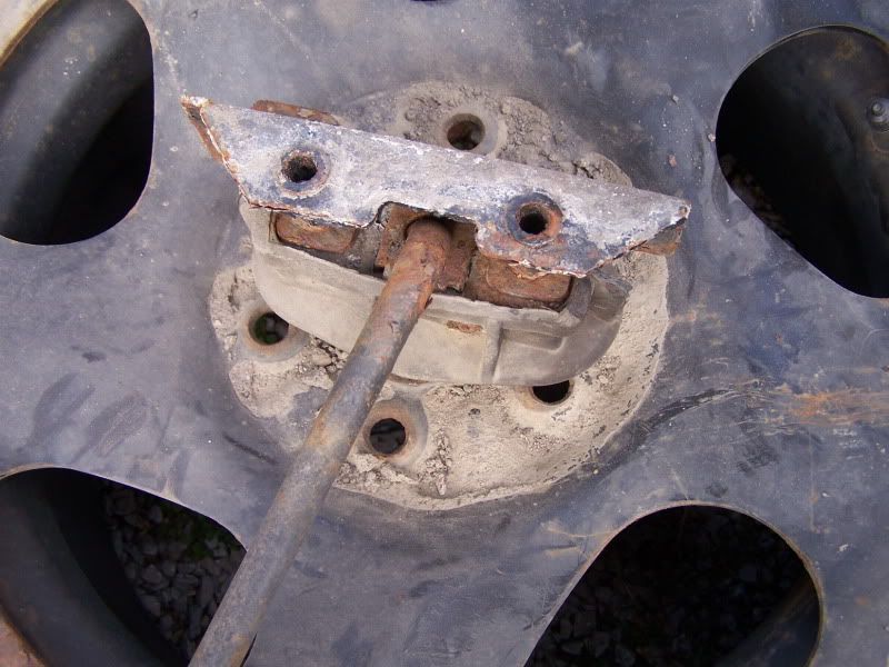

As I started the project, I also wanted to find out why I was having problems lowering my spare tire (like that is a new problem with the TrailVoy family...) and discovered that the cable was sticking out of the winch. I removed the entire assembly for repairs outside the vehicle. Other threads document this problem well, but if I can repair my own winch, i'll document and post that as well.
On to the repair:
Here is the location of the spare tire winch tool for lowering the tire. Use a flashlight to find the square peg deep in the hole -- and the jack handle fits over the square peg to lower the winch.

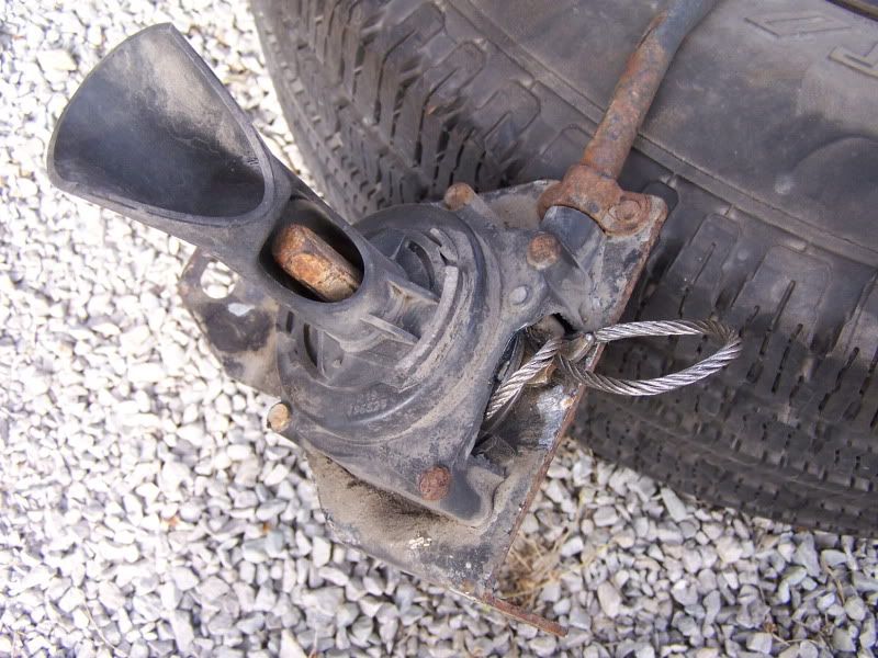

Here is what I found with the spare tire winch. Obviously the tube that leads to the actual spot where the tire hangs from the frame has rusted enough to halt the passage of the cable, and once it twists up like this, it will never work again.
The winch is held up with 3 bolts -- one directly over the spare tire (you can reach it while the tire is still up in position from the passenger side of the vehicle) -- the other two are above the frame rail on the passenger side, and again, can be reached by looking up from underneath. Remove all 3 bolts and lower the entire winch assembly.
